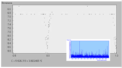

TX UMa is an eclipsing binary system. This article presents a summary of my visual observations, made from the city of Pavlodar, Kazakhstan. The measurements were made time-to-time throughout several years, so the task was mostly an interesting challenge and eye training at the same time. The result has a good match with the known period.

A location chart along with the comparison stars is given below. As TX Uma is an eclipsing detached binary, it spends most of its time in “out-of-the-eclipse” state, having an average brightness of 6.9m. Every 3 days 1 hour and 32 minutes its brightness dims to 8.8m. The star is a good target to look at with binoculars. A light curve built from my observations can be seen just above. The eclipse lasts for 8 hours 50 minutes, so every 15-18 minutes the star adds 0.1m to its brightness.
Based on my observations, the minimum of TX UMa can be calculated using the following equation:
Due to the fact that the period of TX UMa is close to 3 days, every 45 days there is a sequence of 3-4 nights with the eclipse phase visible every night. This is very convenient for observers.
