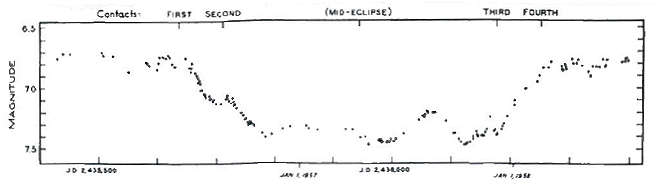

VV Cephei eclipsing binary systems offer the most detailed method of studying mass loss from cool supergiant stars. The long-period of VV Cephei gives it a unique place among eclipsing binaries, but 20.4 years between eclipses make it really hard for scientists to study the system. Such a long interval gives only a couple of eclipse events in a working astronomical career for a human. Similar binaries are always good targets to follow, as the opportunity to obtain quality photometry and spectrometry of the eclipse is quite rare, but rewarding.
The system of VV Cephei, also known as HD 208816, has many features of exceptional interest. It is the prototype for a class of longperiod eclipsing binary stars, with an M-type red supergiant as the primary and an early-type blue (usually B) supergiant or giant companion, and small variations in light. VV Cep is also an extraordinary example of a mass-exchanging eclipsing binary, in which a distorted, inflated red class M2 supergiant orbits a fainter, but much hotter, blue-white star. The pair orbits with a period of 20.4 years (7430 days, actually). The next eclipse is expected in 2017

super-giant, the light drop from the binary during an eclipse is approximately
20% less than when both stars are fully visible.

The eclipse of 1976-1978 lasted about 1000 days of which the totality was about 300 days. More advanced hardware allowed to obtain very good samples of data in different bands. An in-depth analysis of the light curve during that eclipse is presented in the paper "Photometric study of VV Cephei during the 1976-78 eclipse" (Saito et al., 1980).
